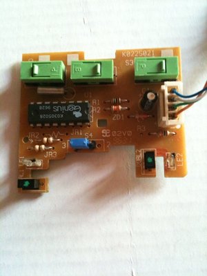

Dear All,
I had a second thought and took the mouse appart. On the PCB I found a vacant placeholder for a switch marked S4, with three connection pins 3 x 2. There was a permanent truck between 2 and x, that I tripped. I have soldered in a three pin switch, and bridged 3 and x.
Please see picture. I remembered your earlier suggestion, and kept the left mouse button depressed at power on.
I am now getting PC mode 8bit data packets.
So it seems Genius late models with 2-3 switch, EasyMouse, MyMouse, Mouse-3, etc, are good with QL, after all. There are two flavours, with or without a mechanical switch, but the switch can be soldered in.
